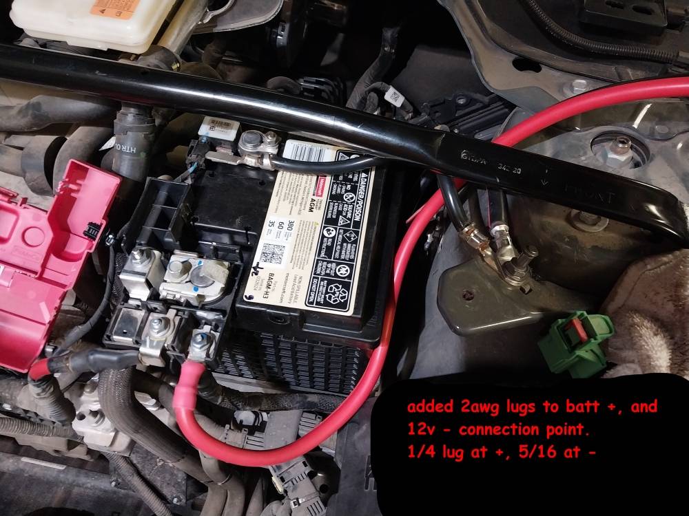

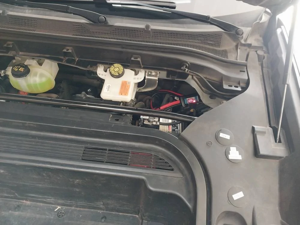

Although my 12v battery does not need replacement, I am curious whether it can be removed/replaced, when that time rolls around, without removing the frunk tub. Is that possible? ThanksGood point. In the video they used the wrong battery. Which doesn't have the proper hold down foot, so the battery is completely loose when installed. Bad. That is an improper repair, the battery always needs to be 100% tied down so it can't move, otherwise you risk a fire if it moves and touches ground.
Spend the money and get the proper H3 AGM replacement battery so it fits and works properly. No substitutions.
