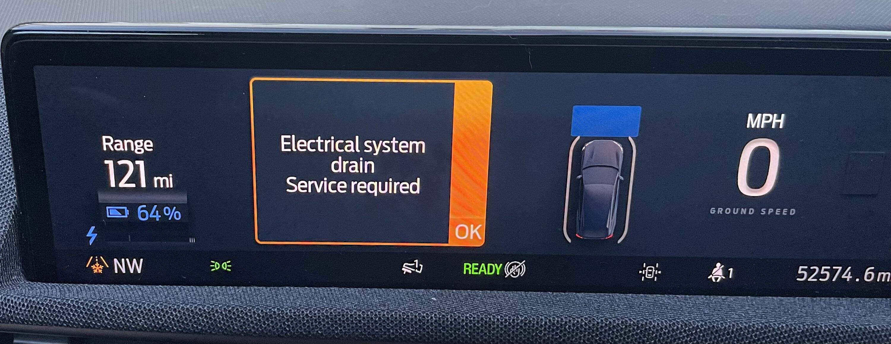

I wanted to share my experience when I got the “electrical system drain” message. I’m not technical so I’ll do my best.
I took it to my dealer and they said the battery management sensor was bad and ordered a new one. While waiting the week for it to come in I had a slight burning smell in the cabin but thought it was from another car.
The part came in and the sensor was replaced. There was a continued battery draw at the 12 volt system. Testing showed the DC/DC converter was not shutting down and was overheating causing the battery drain. New converter ordered and 3 days to get it shipped. Dealer was able to provide a loaner.
DC/DC converter was replaced and battery draw was still happening. Further testing showed the 200 amp fuse was open and a new one ordered, 2 days to ship.
200 amp fuse replaced and no battery drain noted. Now the 12 volt battery was losing CCA due to drain and showing erratic voltage readings so a new one was installed. Battery SOC 83%.
Total of 8 days in the dealer and I did open a case with the BEV team to report it. The scariest thing was realizing I must have been smelling the DC converter overheating while I was driving. The dealer did a great job of taking care of it all.
